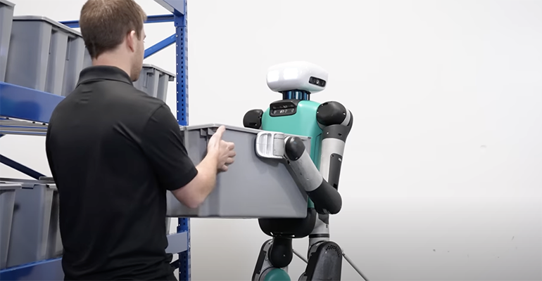

But maybe you’re looking for a multipurpose robot to do logistics work, since you can’t seem to keep anyone in that job for more than six months? Meet Digit, a creation of Agility Robotics. The so-called human-centric, multi-purpose robot is designed to “go where people go and do useful work safely in spaces designed for people,” to quote the company. The next-generation Digit strutted its stuff this week at ProMat 2023 in Chicago, and you can see its evolutionary development in the video embedded on this page.
Next-gen Digit robot will take on dull, dirty, and dangerous tasks and free up staff to do more creative and complex work, according to Agility Robotics.
“Supply chains are still feeling the aftereffects of the pandemic,” said Damion Shelton, co-founder and CEO of Agility Robotics. “Companies are turning to automation now more than ever to help mitigate future disruptions. With logistics labor issues such as high turnover, burnout, and injury continuing to rise, we believe Digit to be the future of work. We look forward to Digit augmenting workforces, taking on the dull, dirty, and dangerous tasks, and allowing people to focus on more creative and complex work. We like to think of Digit as enabling humans to be more human,” said Shelton.
Agility is opening up a limited number of spots in its Agility Partner Program (APP) for companies that want to deploy Digit in their warehouse and supply chain operations. Through on-site visits and dedicated engineering resources, Agility will work closely with APP partners, who will have the opportunity to influence the development of new skills and capabilities for Digit based on their real-world use cases. Additionally, APP participants will get exclusive early access to the new Digit before it is commercially available, said the company on its website.
