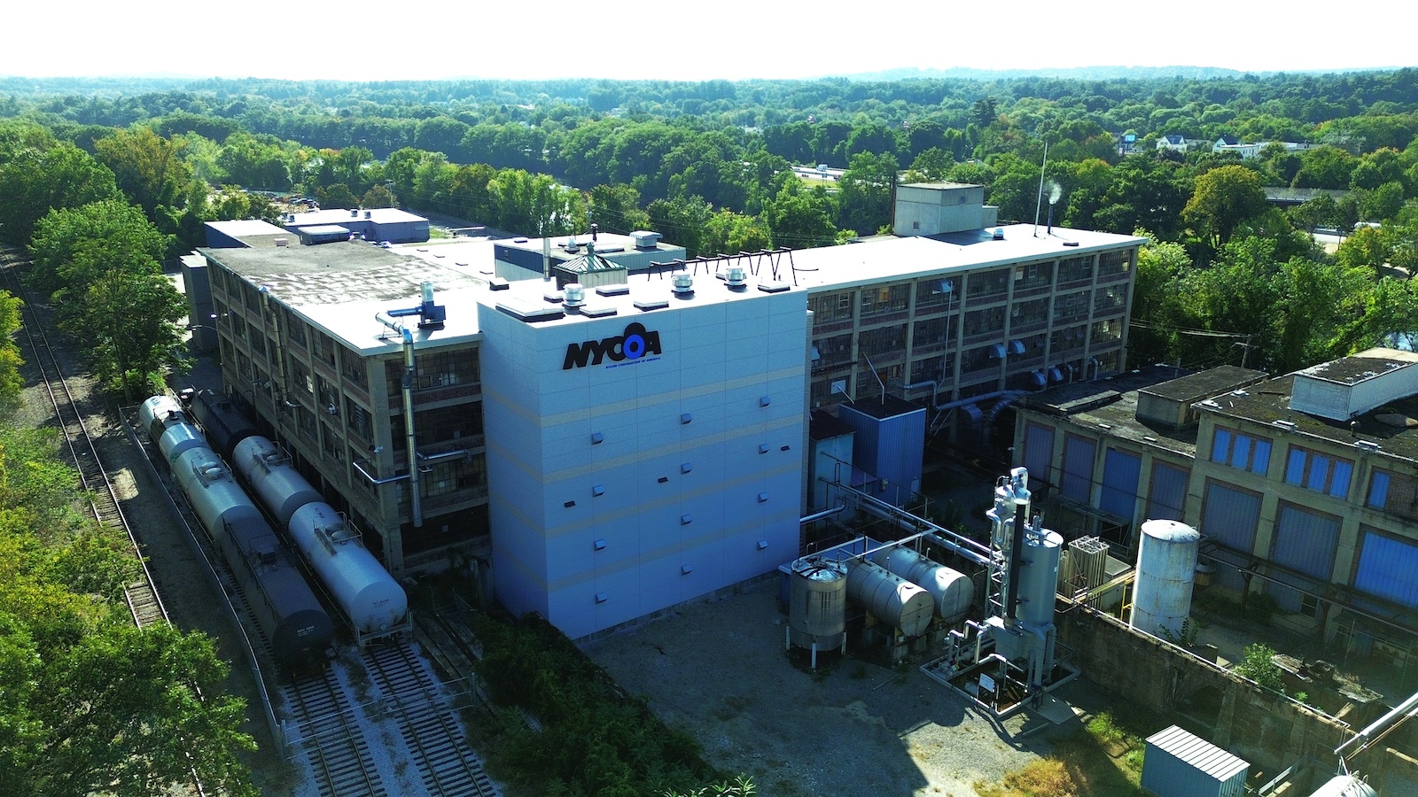

Nylon Corporation of America Inc. (NYCOA) has expanded its product offering and added new production capacity as part of its transformation into a specialty polyamide (PA) supplier. NYCOA has introduced three new long-chain PAs and started up new polymerization lines at its existing Manchester, NH, headquarters. The company will discuss the latest developments at NPE2024 on May 6 to 10 at the Orange County Convention Center in Orlando, FL. It is exhibiting in booth S34115.
A domestic supplier of PA 6 and 666 copolymers and PA 66 compounds since 1957, NYCOA is re-inventing itself by taking its material development and manufacturing know-how to a new level. The company has undertaken a new growth strategy and elevated its leadership role in high-performance PAs by investing and expanding in its R&D efforts and focusing on developing innovative solutions and technologies. The new capacity in Manchester ensures a dedicated future supply of these new long-chain PA products for a range of markets, including transportation, industrial, and sporting goods.
