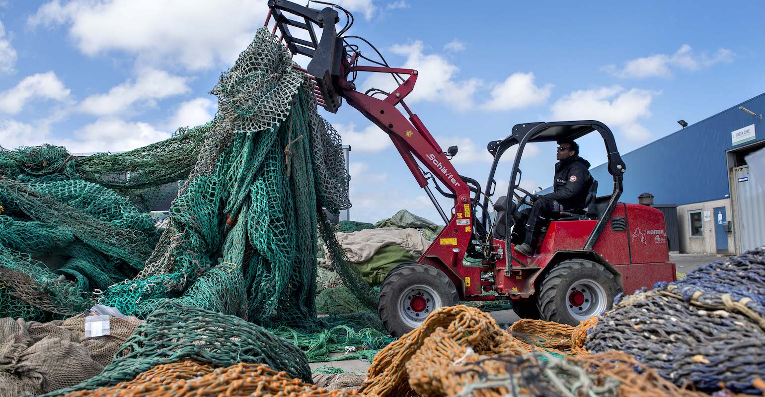

waste fishing nets
Image courtesy of BMW
The next series of BMW iX and BMW X1 models due for launch starting in 2025 will not be amphibious but they will feature trim parts made of plastic with around 30% recycled fishing net and rope content. This raw material is proactively sourced at ports all around the world to ensure that it doesn’t end up being discarded in the sea.

In a new initiative developed in cooperation with the Danish company Plastix, the automaker is taking the recycling of maritime plastic waste a step further. After separation, fishing nets and ropes undergo an “innovative process” that produces plastic granules. While recycled maritime plastic has so far only been used in the automotive industry in the form of fibers for new vehicle components, this recycled material is also suitable for injection molding for the first time. The raw material for the components manufactured in this way can consist of around 30% maritime plastic waste.
