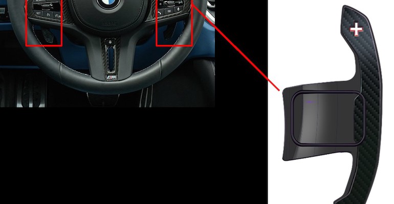

BMW M has selected Ineos Styrolution’s StyLight aesthetic styrenic composite as the material of choice for a new generation of ergonomically-optimized carbon shift paddles.
The selected material for the shift paddle application, Ineos Styrolution’s carbon composite StyLight Aesthetic S C245-1-060, was back-molded with PC/SAN GF30. It was specifically developed for automotive interior and exterior applications and a range of applications in the electronics as well as the sports and leisure industries.
Carbon-look paddles power BMW M car. Image: BMW
In addition to its aesthetic appearance, StyLight offers a high chemical resistance. The StyLight solution meets all high BMW M standards.
A significant benefit of the solution is its cost-effectiveness. For example, StyLight can be used without coating (compared to a PC-based composite) and no extra compression molding step is required since the high surface appearance is achieved directly by the back-molding step.
