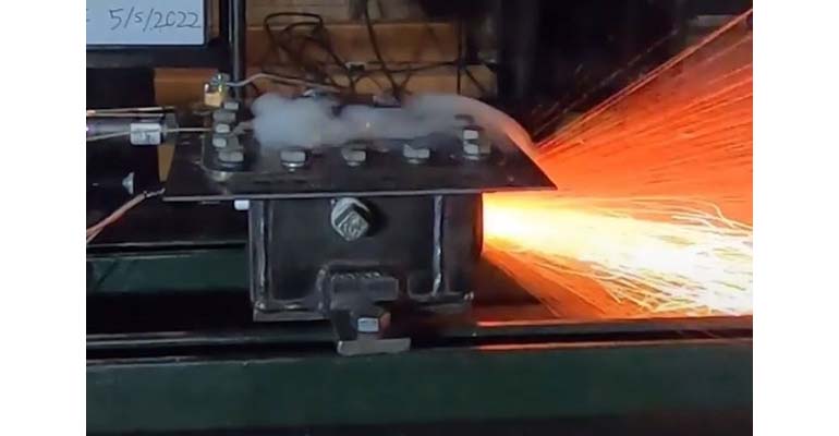

SolvaLite 716 FR is primarily targeted at flame-retardant battery enclosure applications for premium and super-premium BEVs. It has a dry glass transition temperature (Tg) of 145°C (293°F) and has been shown to outperform aluminum and discontinuous-fiber composites in practical UL 2596 flammability tests by providing protection at a wall thickness of just 2 mm. Beyond the automotive industry, the new material also opens up potential for other components where fire safety is key to meeting general UL94 V-0 specifications.
