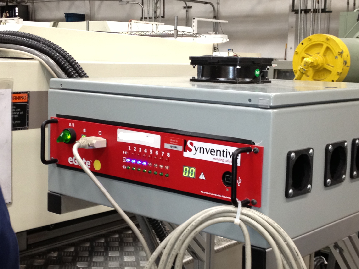

While traditional valve gates are hydraulic or pneumatic, the eGate is electric.  Each valve pin is coupled to an electric motor with an encoder that precisely records real-time position within 0.01mm.  The valve pins are individually programmed to move as fast or slow as you want to.  A hand held pendant allows a molder to adjust gate vestige and stroke on the fly.  As with electric molding machines, eGATE provides a higher degree of precision and repeatability compared to conventional valve gates.
Out on the shop floor as once-problem parts ran successfully from the machine, Cook plugged his lap top into the eGate system and pulled up a control screen. Lights are green and red, showing whether gates are opened or closed. For this profile, there is a 6-mm open stroke. In the control, pink signifies the distance from "home", with blue showing the velocity and "speed limit" for the pin, allowing molders to set the rear zones.
The display showed the pin open at 12.5 mm, retracting at 3 mm, then opening slowly for 2 mm before speeding up for the rest of the way. The system can also save and store processes, and allow users to pull process set-up reports, giving you the nozzle, stroke length, and open position. Pin-position profiling verifies the pin's location numerically and graphically. With one system, molders can control up to eight zones. They can also daisy chain eight systems together for individual control of 64 cavities.
