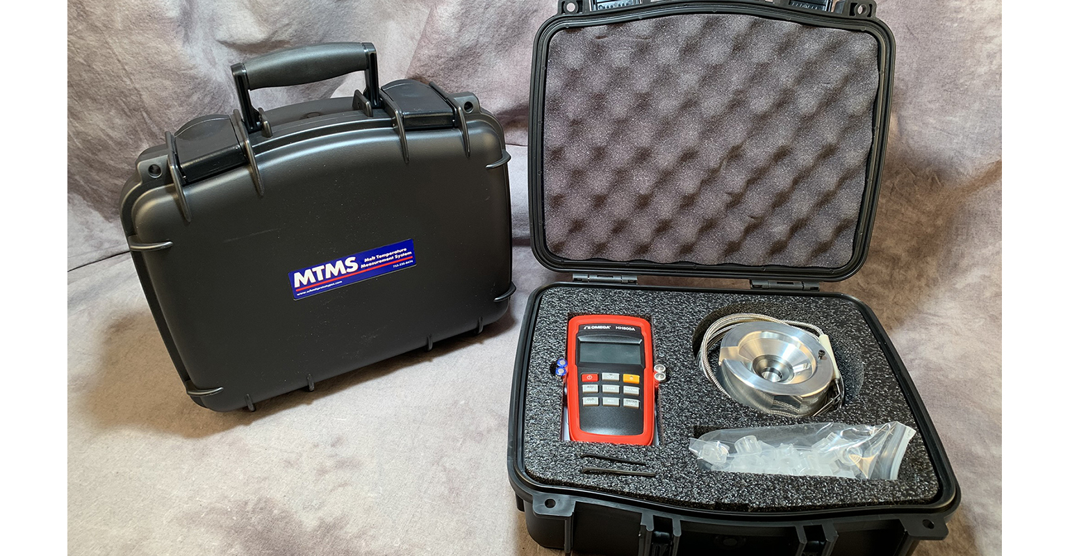

The material is maintained in a molten state in the insulator cup during the measurement process.

The MTMS method is based on an insulator cup that keeps the material in a molten state during the measurement process. It also precisely positions the thermocouple probe in the effective flow path. The process is shown in the embedded video. In addition to its low cost and ease of use, Bleck cites the following advantages compared with conventional technologies:
  • The ability to measure shot sizes under one ounce;
  • once the process has been stabilized, it takes only one shot to measure the melt temperature;
  • minimal downtime, generally under one minute;
  • excellent repeatability between operators.
