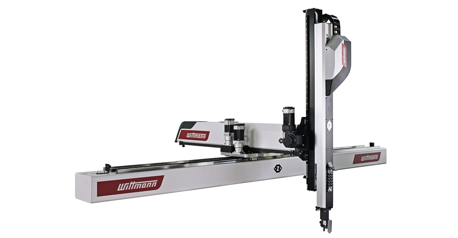

Wittmann Battenfeld Primus 48-T robot

The company’s Primus robots are designed for pick-and-place applications, and Wittmann Battenfeld recently expanded the series with the largest Primus model yet — the Primus 48T. The 48T carries a 20-kg payload and has clamping forces between 20 and 900 T while maintaining the smooth and quiet operation for which the Primus series is known.
