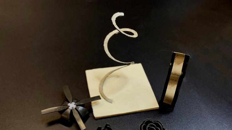

Researchers from the Georgia Institute of Technology (Georgia Tech) and The Ohio State University have developed a magnetic shape memory polymer that can transform into a variety of shapes, paving the way for new capabilities in robotics and electronics, they said. (Source: Georgia Tech)

To create the material, researchers first distributed particles of neodymium iron boron and iron oxide into a mixture of shape memory polymers. Once the particles were fully integrated, they then create various objects from this mixture to test how the material would perform in various scenarios.
One example the team created to demonstrate their material was a gripper claw, which they fabricated from a t-shaped mold, researchers said. They applied a high-frequency, oscillating magnetic field to the gripper to cause the iron oxide particles to heat up through induction and warm the entire object. This rise in temperature than caused the material to soften, which made it pliable.
Researchers then applied a second magnetic field to the gripper to make its claws open and close, they said. Then, once the gripper cooled back down, whichever position it was in at the time remained locked.
Locking in the shape
The shape-changing process takes only a few seconds from start to finish, and the strength of the material at its locked state allowed the gripper to lift objects up to 1,000 times its own weight. “This process requires us to use of magnetic fields only during the actuation phase,” said Zhao. “So, once an object has reached its new shape, it can be locked there without constantly consuming energy.”
Researchers published a paper on their work in the journal Advanced Materials.
The team also tested other applications for the material, making coil-shaped objects that can expand and retract. This particular function simulates how an antenna could potentially change frequencies when actuated by the magnetic fields.
