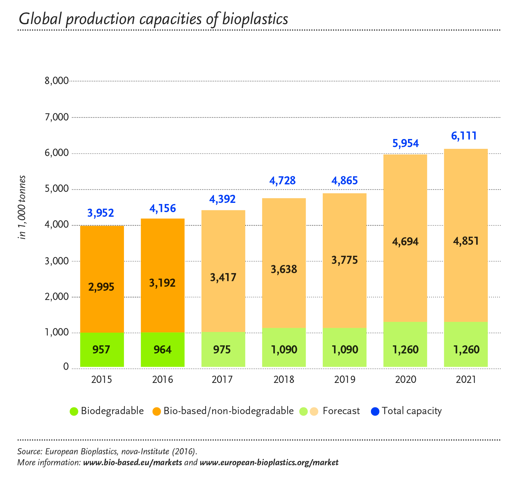

First, the good news. An upbeat François de Bie, Chairman of European Bioplastics, predicted a market growth of 50% for bioplastics over the coming years, despite the low oil price. The annual data presented at the European Bioplastics conference yesterday showed that production capacity is set to increase from around 4.2 million metric tons in 2016 to approximately 6.1 million metric tons in 2021. While packaging remains the single most important application area – it accounted for 40%, or 1.6 million metric tons of the total market in 2016 – other sectors are getting in on the act.

Biodegradable plastics, such as PLA, PHA, and starch blends, are also growing steadily from around 0.9 million tonnes in 2016 to almost 1.3 million tonnes in 2021. PHA production will almost quadruple by 2021 compared to 2016, due to a ramp-up of capacities in Asia and the USA and the start-up of the first PHA plant in Europe. Asia, however, will further expand its role as a major production hub. More than 45% of bioplastics production will take place in Asia by 2121,” said Lange. “Europe will hold relatively stable at around a fourth,” she added.
