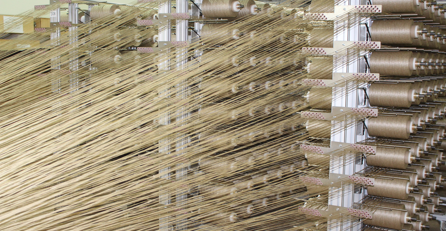

Flax weaving machine
Image courtesy of Wagenfelder Spinnereien
