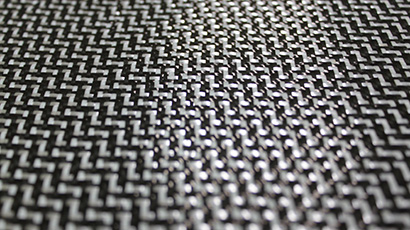

Dyneema Carbon is made by either stacking the fibers together parallel to each other or by interweaving them. The proportion of Dyneema compared to carbon fiber can vary anywhere from 10% to 100%, depending on the application. The Dyneema causes the carbon hybrid composite to be more ductile, reducing brittleness. “Working with our customers, we simulate performance applications in order to provide them with the product that fully meets their requirements,” said Motahari Pour.
