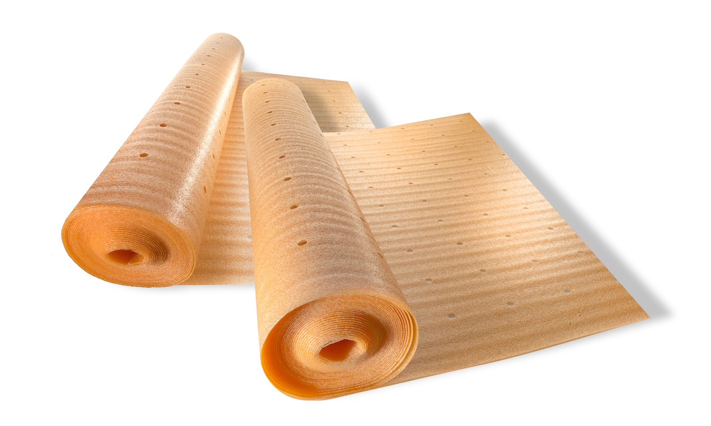

Already, several breakthrough innovations are in the process of being commercialized. Sabic LDPE 2502X0, for example, offers special benefits for the physical foam extrusion process, as well for the resulting lightweight foams. Sabic LDPE 2402CX0 offers benefits for crosslinkable (XL) foam extrusion processes. The XL foams have an improved properties-to-weight ratio, offering the possibility to use them in higher added-value applications.
A new series of “fast converting” foam material solutions developed by the company that provides further improvements in the production efficiencies of foam manufacturers are now also available. Sabic LDPE 2102FC is the first in a series of products that combine up to 50% savings in degassing time – reducing the foam manufacturer’s inventory – and an improvement in production efficiency of up to 5% through less production waste and better foam consistency.
