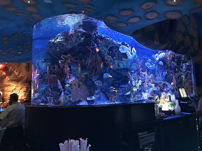

The aquarium at the T-Rex restaurant at Walt Disney World in Orlando, FL, failed in 2014, when a vertical bonded seam opened instantaneously. Image courtesy Paul J. Gramann.

T-Rex, Walt Disney World, Orlando, FL: On March 17, 2014, just as dinner was being served at the T-Rex restaurant at Walt Disney World, a vertical bonded seam opened instantaneously in a large cylindrical aquarium. The aquarium was located adjacent to dining tables resulting in a number of people becoming drenched. The opening was approximately three feet long, giving employees time to transfer fish to other aquariums located on the grounds.
