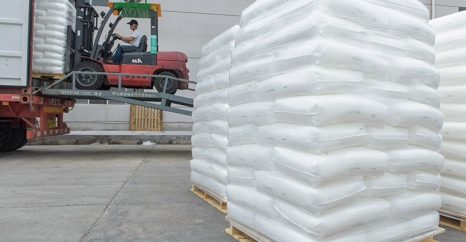

ExxonMobil Exceed S resin
Image courtesy of ExxonMobil
ExxonMobil today introduced a new polyethylene (PE) resin platform designed to produce stiffer and tougher products than competing materials while being easier to process. The Exceed S performance PE resins allow users to reduce the complexity of film formulations and designs while improving film performance, conversion efficiency, and packaging durability compared with currently available products, the company said.
