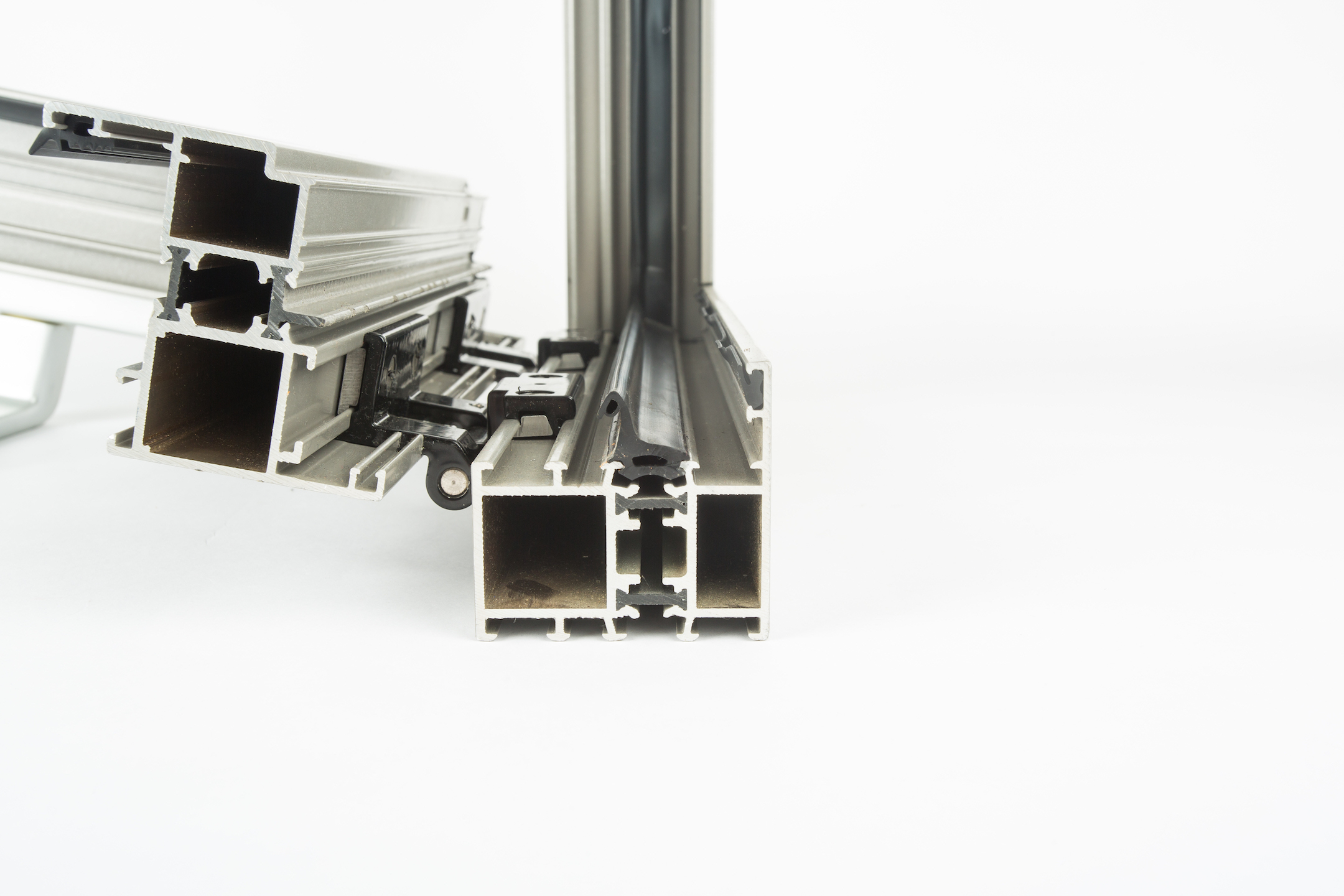

Arlanxeo is also showcasing its Keltan Eco EPDM grades, the world’s first EPDM rubber based on bio-ethylene produced by Brazilian resin manufacturer Braskem.
Depending on the ethylene content of the particular grade, the bio-based content of Keltan Eco EPDM rubber ranges between 50% and 70%. Detailed studies have shown that the polymer characteristics and the technical performance of Keltan Eco EPDM are identical to those of the corresponding conventional products. Independent Life Cycle Assessments of Keltan Eco EPDM grades versus their equivalent Keltan EPDM product have shown that the CO2 emission is reduced by more than 50%, or in other words Keltan Eco EPDM saves the emission of 4-6 barrels of oil used for production per mt EPDM. Today these new bio-based EPDM grades are commercially applied in applications, such as low-weight, micro-porous automotive solid seals, flooring and window seals.
