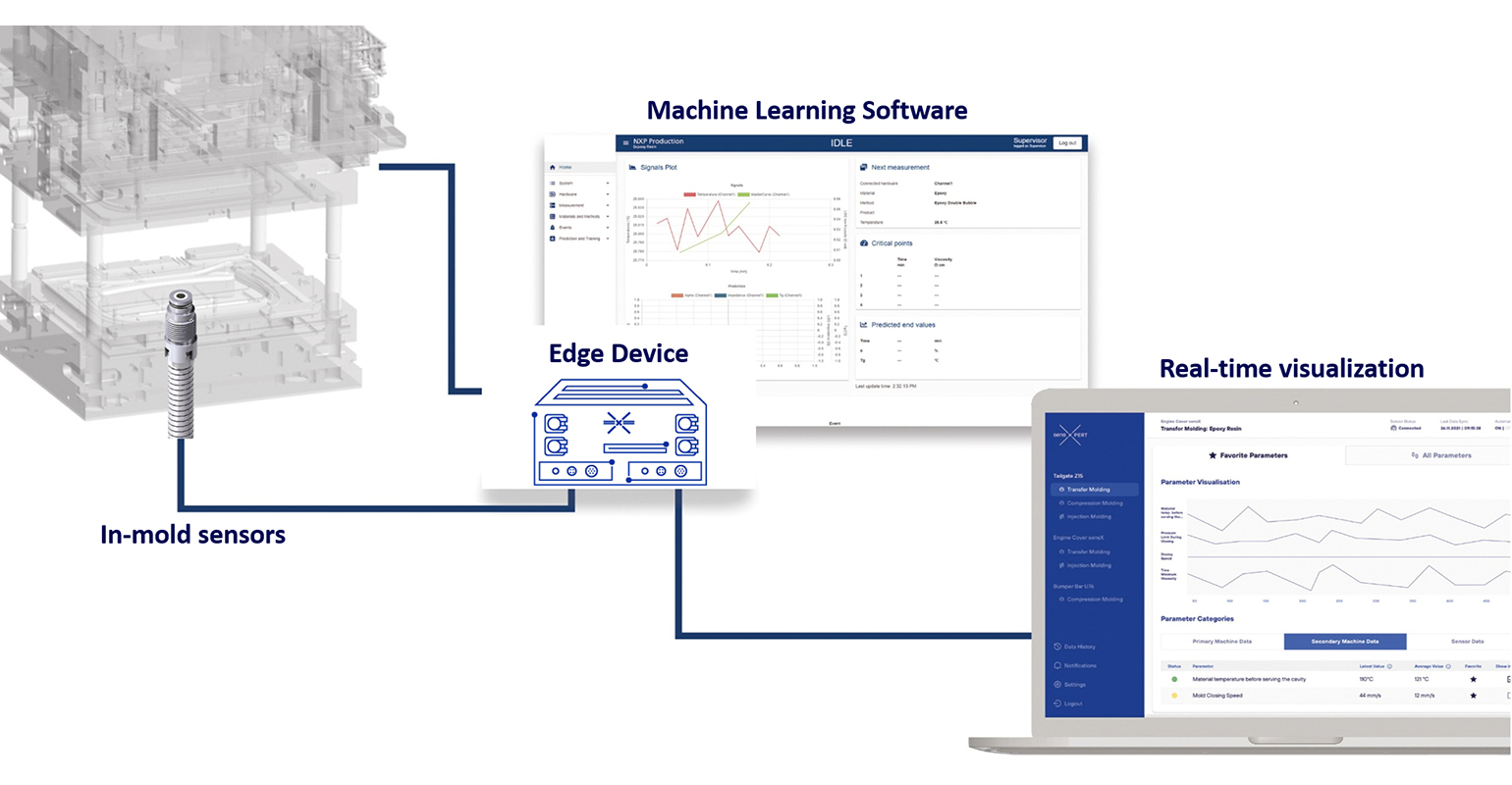

diagram of SensXPERT technology
Image courtesy of NETZSCH Process Intelligence
A new, smart process system that combines real-time mold data with machine learning software promises to increase plastics manufacturing efficiency by as much as 30%.
SensXPERT technology from Germany’s Netzsch Process Intelligence analyzes material behavior with in-mold sensors that allow dynamic, adaptive production by reacting to material deviations, the company said. Customers can connect sensXPERT to existing manufacturing and control systems with standard interfaces, or use it as a cloud-based service.
Central to the sensXPERT manufacturing solution is the Edge Device that assesses hardware and software to produce models that capture the most minute deviations in material and process. The resulting algorithms simulate, predict, and analyze material behavior on individual machines. Key parameters like glass transition temperature, pressure, and curing requirements “train” these process models, which are continually refined.

SensXPERT provides a real-time window into plastics processing parameters to ensure quality.
