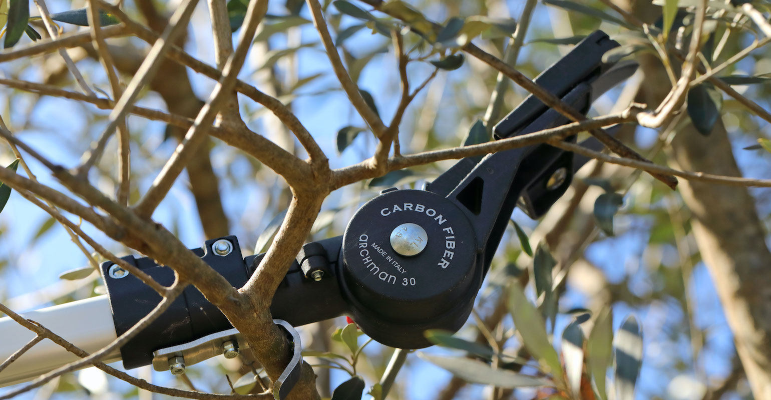

Archman srl, an Italian manufacturer of scissors for viticulture, horticulture, and gardening, has chosen Domo’s Econamid Air for its Helium electric tree pruner. An extremely light tool, weighing only 1.63 kg, the cutting body of the new product is molded with the sustainable polyamide- (PA6) based compound with carbon fiber.
The material’s lightweight, strength, electrical conductivity and sustainability credentials, made Econamid Air the ideal material for this application. The lightweight nature of the material offers comfort for the user, while its electrical conductivity prevents the accumulation of energy, and the risk of unpleasant small electrical shocks during use.
Domo, with the help of Italian distribution partner Guberti Spa, worked in close collaboration with Archman from the early development phase through to launch to ensure that end of life considerations were taken on board during the design phase.
Strength and electrical conductivity, with light weight and sustainability to boot, are key attributes of the carbon fiber polyamide grade used in an electric tree pruner. Image: Domo
