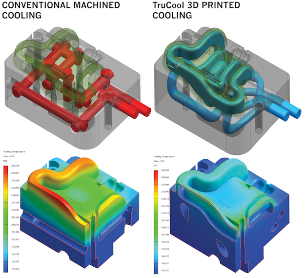

Comparison of heat-transfer performance between TruCool 3D-printed conformal cooling and conventional technologies. |
DME’s TruCool starts with a detailed review of the moldmaker’s or molder’s requirements; with the use of advanced 3D CAD modeling and FEA software, the DME technology team can simulate lifelike and optimized cooling channels. The resulting channels provide greater overall coverage, even distribution of cooling and the ability to provide individual insert temperature control.
